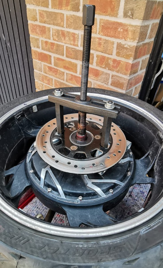

To remove the hub, unscrew the 12 screws on the cable side and use a bearing splitter to push the axle straight out from the other side, with the parts of the splitter positioned behind the brake disc.
Forget about trying to separate the cover plate and dissect the seal, don't bother. Leave the plate on, let it come off with the hub and axle. All I did was mark and scratch the mating surfaces to no effect at all trying to do that the first time, and leaving the plate in place helps keep the axle aligned and not rubbing on the magnets (if you use the guide bolts I show here). Press it straight out, and it tears the sealant no problem.

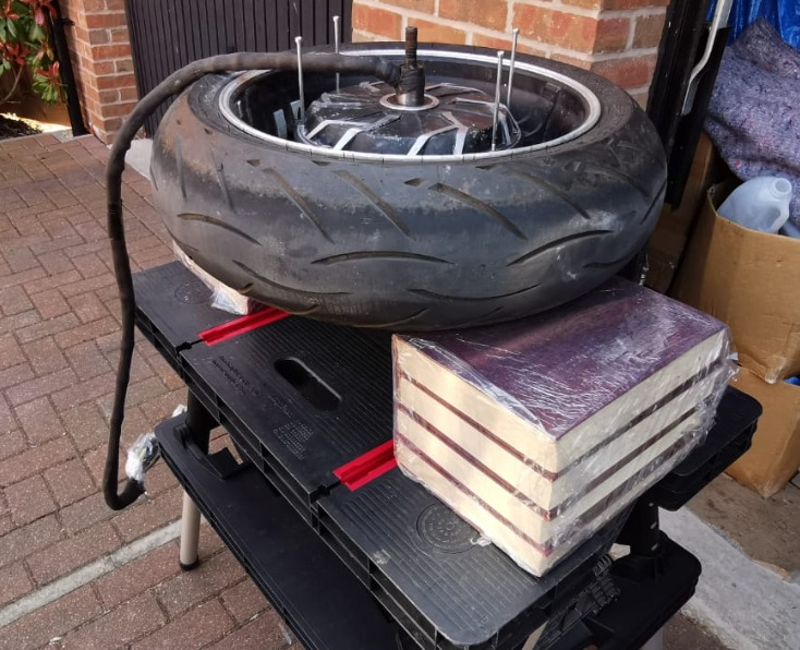

I recommend supporting the wheel either side on something substantial, you need around 200mm clearance underneath, I used some encyclopedias I had and wrapped them in pallet wrap to keep them clean.

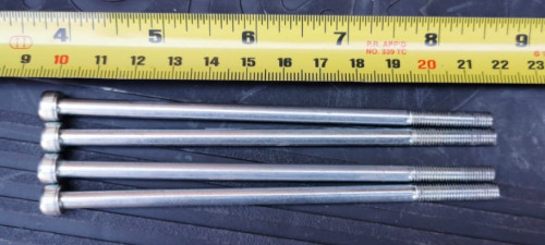

I recommend getting some long coach bolts that will help keep everything straight and not fly around. 4 is enough to stabilise it.
Then, flip it over and press it out. Put something soft underneath, I used a transit blanket (see the grey blanket underneath in the last photo), and the axle can then drop softly on to it.
Having done this 3 times now, I recommend wrapping up the cable ends as soon as you disconnect it from the controller. That keeps the connectors safe and makes it easier to withdraw and re-install the cable, as well as protect them. You can see in the photo that the cable ends are wrapped up in pallet wrap.
Keeping the plate aligned with the bolts and pressing it out from the other side is very controlled and simple. There is no drama and no difficult steps if you do it like this.

Thank you Bob! Nice and controlled way to push stator and rim apart.
Any hints on reassembling the motor?
I guess it won't be a good idea just to let the stator snap uncontrolled into the rim with the magnets.

So the tricks are to use the guide bolts (m3 ? m4 ?) and the "puller" (as a push-limiter or push-controller) to tame the magnetic force in the way that it reassembles it all.
I have watched it coming out and going in, and the poles don't even touch the magnets.
I have a video of it, I'll see if I can post it.
M5.
