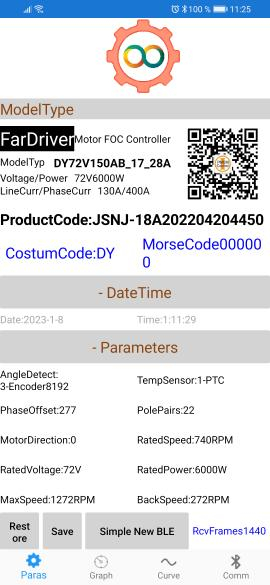

Wo findet man das denn? Welche App-Version?
Hi Jeff, you already have the link - viewtopic.php?f=157&t=16646&p=300178&hi ... le#p300178 :)
Yeah, I know where to find the *.apk (already got it). :roll:
:arrow: I just asked where I can find the "expert mode" at the parameter screen...?
Maybe it's only available when the controller is an off-the-shelf fardriver, and not with our custom DAYI-version?

I have Dayi version of FD and expert mode is there, you switch it on title screen (on photo it is already on so there is Simple instead of Expert).

I have Dayi version of FD and expert mode is there, you switch it on title screen (on photo it is already on so there is Simple instead of Expert).103410.jpg
Ok, so it seems that my MotorNet 1.5.4. only knows the Expert-Mode, there are no modes to switch in between.... and I can access these parameters.
Thanks!
