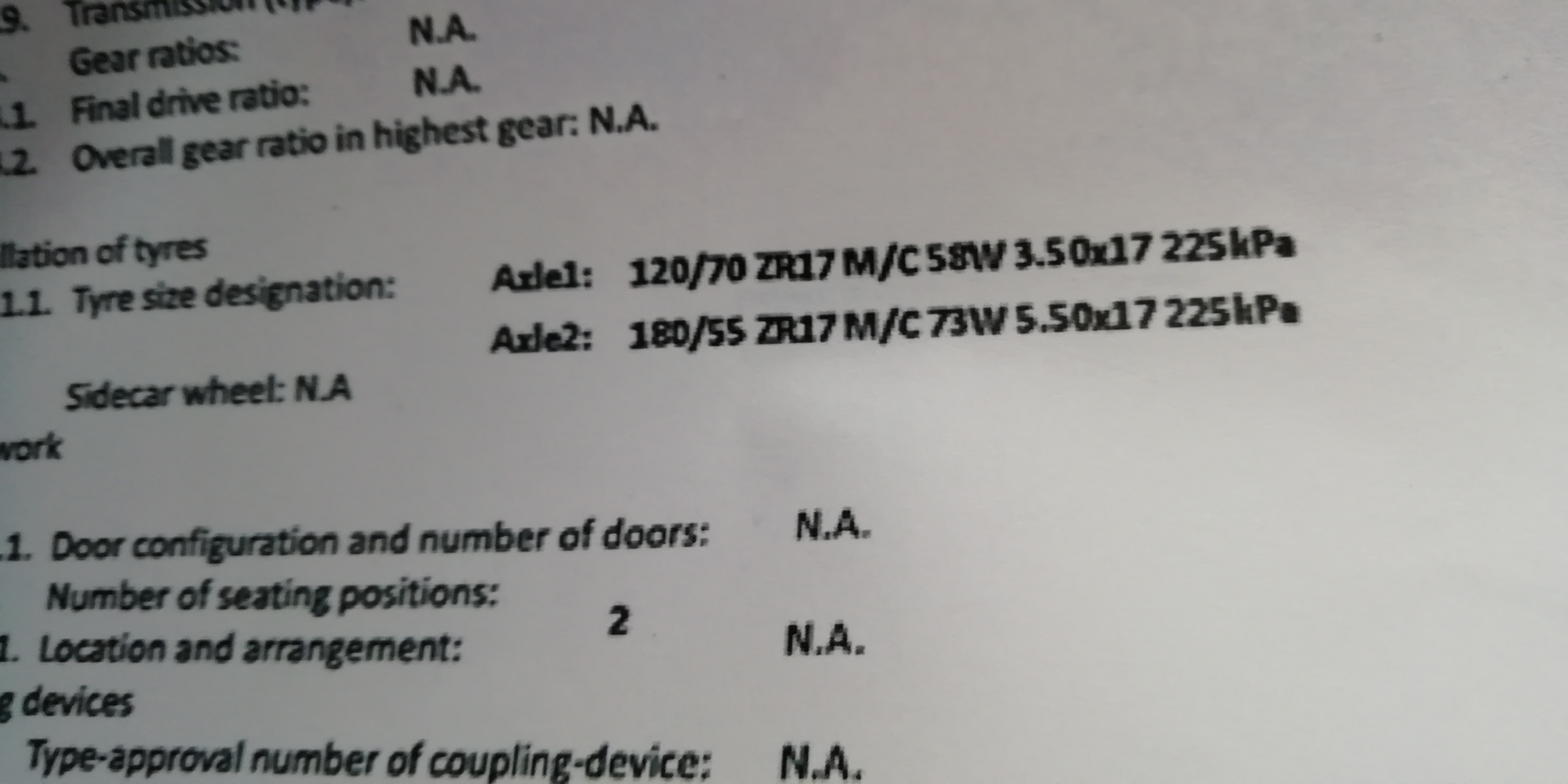

Hi guys,
well, nobody sent me COC list for 10kW so I am not able to ask DMV and find out the law requirements for changing 6kW motor for 10kW
At least, can anybody look into his 10kW COC list and tell me what size of rear wheel rim is written there ? 5.5" with 180/55 R17 or 6" 180/70 R17 ?
Thanks.
Thanks.

Hi Miguello, bei mir ist allerdings von Anfang an auch ein anderer Vorderreifen eingetragen, da Auslieferung mit MAXXIS-Reifen war.Miguello80 hat geschrieben: ↑Fr 23. Aug 2024, 16:07Hi guys,
Thanks.

Oh man, thank you !Zimmermännche hat geschrieben: ↑Fr 23. Aug 2024, 18:47Hi Miguello, bei mir ist allerdings von Anfang an auch ein anderer Vorderreifen eingetragen, da Auslieferung mit MAXXIS-Reifen war.
So the same as 6kW Odin. I believe 10kW motor should fit into 6kW's swing arm, if it has the same 230 mm dropout (width inside the swing arm).
My buddy will ask his friend with connections in China to try to buy two 10kW AMR motors. There is no chance to buy that motor separately, at least here in Czech Republic.
Because there is no informations about "AMR" motors + they do not have temp sensor, I am looking also on QS and Yuma motors. But it seems that they do not produce 10/11kW motors on 5.5" rim, only 12kW on 6" rim but that is not so important, 180/55 R17 will fit 6" rim so the motor replacement should not be too obvious when 12 kW is over the legal limit
But this is a big future, now I am buying EV so money goes there.
Anyway, thank you again.

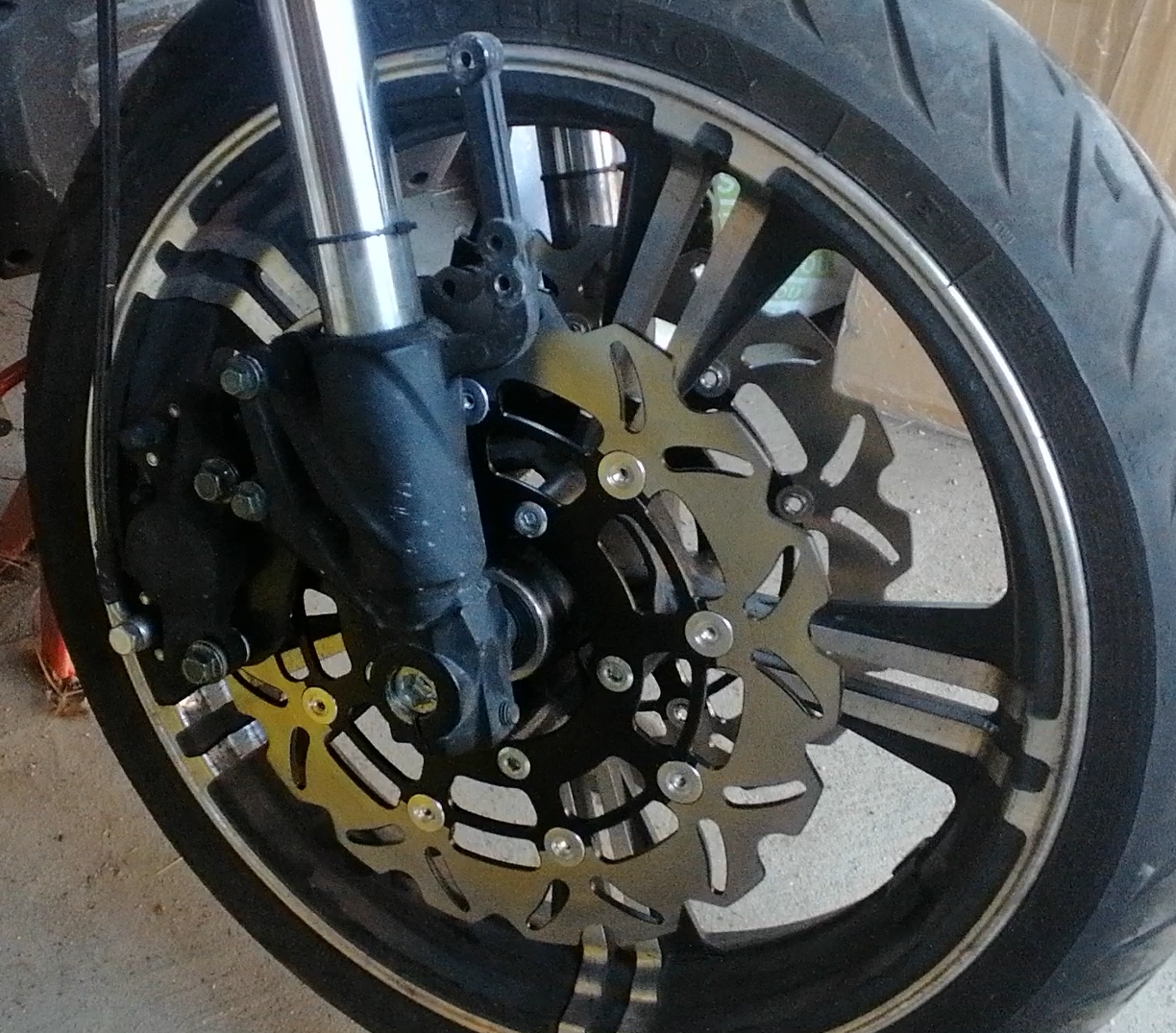

Muhehehe, finaly I replaced warped factory discs with new (floating) brake discs. I know, I did not mounted them symmetrically "wave to wave", I noticed it later and I like it more this way.
I was affraid that these 300 mm discs will be too wide (factory discs are 297 mm) but no problem. Maybe because I changed also brake calipers for Brembo as I posted earlier. I can not guarantee that they will fit with newer version of brake calipers (HSK racing, those WITHOUT red "buttons"), they should fit with classic version of brake calipers (those WITH red "buttons")
Wow, braking is great again, no kicking from warped discs.
No, I will not buy any factory part, even when these new brake discs will not last long, I will find any other solution than original discs.
Squeeking when going to stop (10 km/h and less) is still there but this will solve better brake pads. It seems that neither Brembo brake pads is a certainity of silence.
Google 300mm brake discs for Lexmoto. 5 holes 10mm, D 300 mm, d 120 mm (circle through middle of mounting holes), inner diameter 100 mm.
For example here: https://www.ebay.com/itm/176249083864 and with better specifications here: https://www.cmpoparts.com/part/BRDF031
