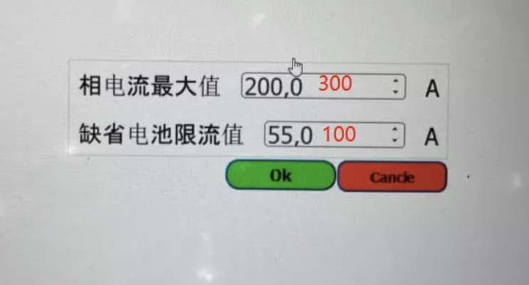

@ Kadett1: I've got the CN Controller Lingbo 72252 yesterday
now my first experience:
Self learning isn't working like it should
After bring in my settings, the engine is running, but the RPM are low ~ 780-800 rpm (depends on the battery status).
Top speed (GPS - Speedometer w/o function and Mode also on "P") = 63km/h, with the Original controller I have a top speed ~70-72 km/h.
in my opinion the engine can easily go up to >1000 rpm, but all setting I changed --> no impact.
how you did solve this challenge?

Re: Lingbo Controller einstellen
LUQI, CN Brand 13“ 3KW 60V
I‘m in contact with my chinese friends, but till now no solution, only to increase peak to 300A und current to 100A …. no change, and I fear to overload the motor
Let’s see what is the next proposal from them
We will not give up !

My Battery BMS only accept 65 A . With 100 Ampere i fly to the moon.

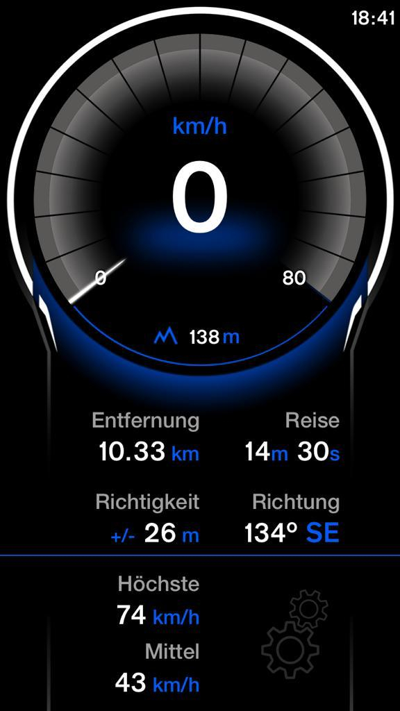

Bisschen gespielt
