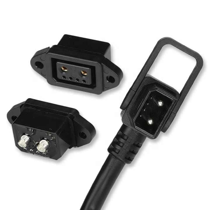

The last question about an ECOOTER E2s was about the battery SOC shown as 0% on the display, while the battery was fully charged.
An other question was about problems with the start of/switch in battery charging.
Maybe it will be helpfull, if You could tell us about the connector pin functions (pin assingnment) of the ECOOTER battrery plug/socket.
Is it this connector type?
VG
VG

If the meter shows 0% charge, there are two problems! 1. If you have changed the power cord or battery socket, please check again whether the communication line is connected correctly! 2. The battery BMS communication fails. In this case, the BMS failure rate is 60%! If you don’t understand what I mean, please contact me via Whats App: +86 18160932618
