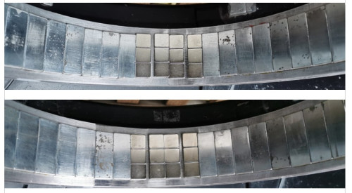

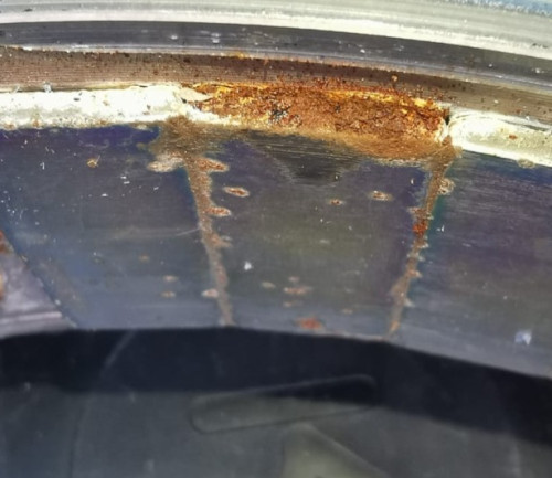

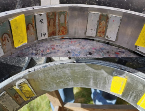

Maybe these photos and the description from TwisterMax might help dismantling the motor.
And here.
And DavidSt dismantled his motor too.

Thank you, yes, indeed.
More photos will help me do the job.
I think I will use a hydraulic trolley jack, and strap it all down to a table, both removal and installation of the rotor.
I think I will find rusty parts, but hopefully not too damaged.
Then I might paint the parts to help reduce this further.
I can also check the bearings and windings for any visible damage.
I'm going to consider this to be 'a service'.
Perhaps it is a good thing to do every few years anyway, to make sure long term rust is removed, and damage does not accumulate due to particles causing wear?
