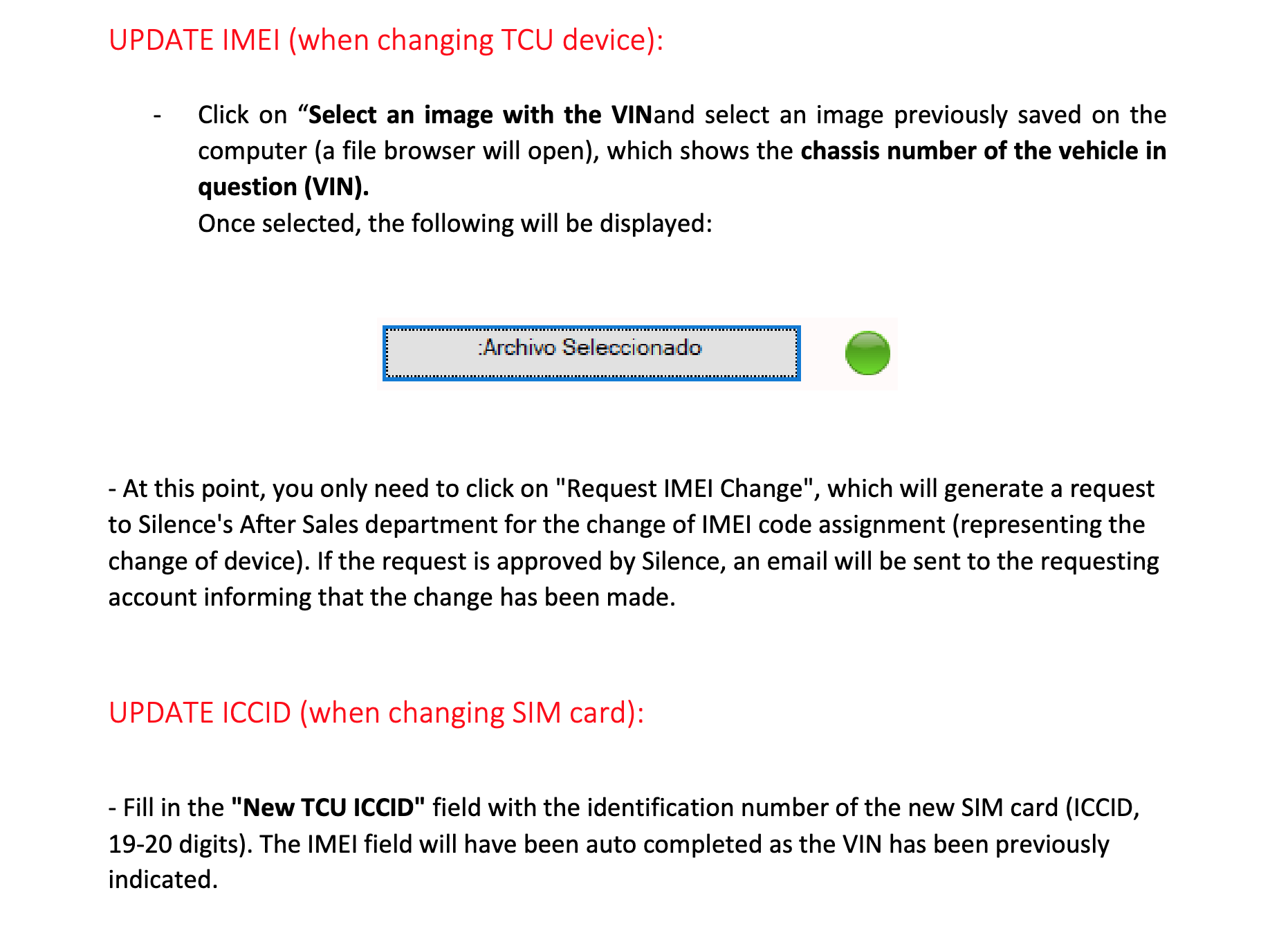

From the Silence Connectivity Diagnostics doku:
