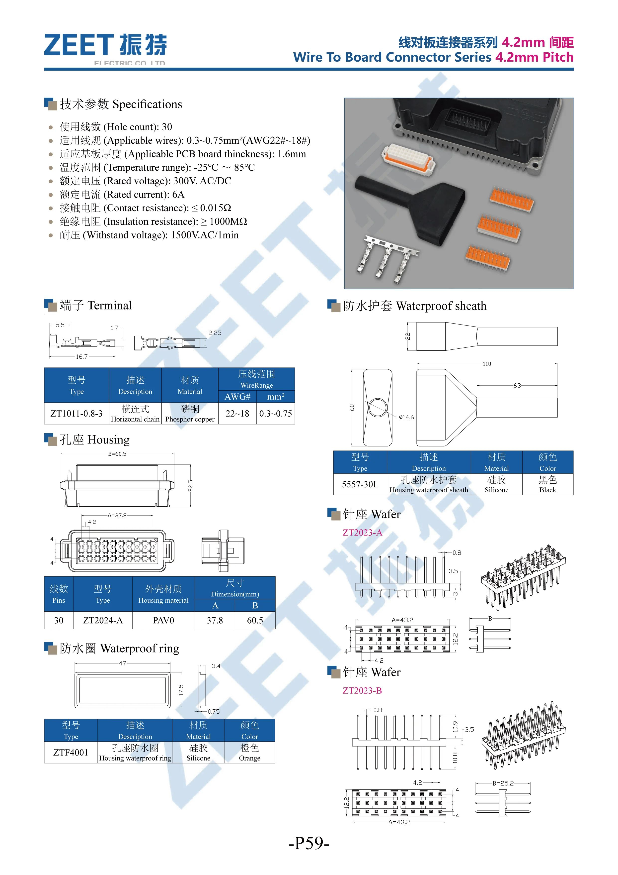

I found out which 30P connector is used in the Lingvo controller, ZT2024-A.
