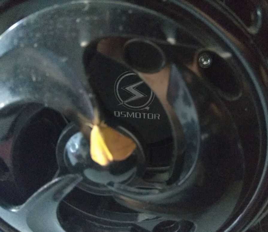

Hi!
I've bought that motor, searched weeks to find info about controller and etc, then teared apart, found the controller part number and searched on that, found that it is the controller of Lexmoto Cypher.
It turned out it is a rebranded motor: Lexmoto Cypher
It has a 1500W controller and 2000W QSmotor, not what M0tr0n seays in spec, it is not 3.7kW and not Bosch motor.

QSmotor written on the mid motor
