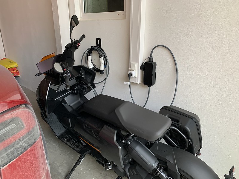

Hi i would like to learn where u get the sidepack and is it easy to install? And also is that the portable fast charger ? How fast it charges ?tuxian hat geschrieben: ↑So 12. Mär 2023, 20:26Ich habe das nun getestet und das Ladegerät beginnt zu laden wenn es stromlos war, beim CE04 bereits eingesteckt ist und danach eingeschaltet wird.
Damit kann ich den CE04 mittels smarter Steckdose zu den günstigsten Zeiten (Awattar) aufladen lassen.
Die Halterung für das Ladegerät habe ich gestern geholt und montiert:

Hi,
this charger charges with up to 2,3kW but I reduced the current to 8A (about 1,8kW).
I bought the sidepack from Louis which is easy to install:
https://www.louis.at/de/sw-motech-urban ... r=10069186
It requires the original BMW bracket (it was mounted at my dealer).
https://manuals.bmw-motorrad.com/manual ... 202111.pdf
Regards
Markus
Regards
Markus
Markus

Re: CE 04 - Schnelllade Verhalten - reale Daten
Hi Markus does it only have right side bracket ? Cuz i went to bmw goslar today they only have right one ? Cant we use it in the both sides ?tuxian hat geschrieben: ↑Do 13. Apr 2023, 21:06Hi,
Regards
Markus
- Norbert
- Beiträge: 3421
- PLZ: 22307
- Tätigkeit: E-Ing.
Hello,
And again, this does not fit together with any of the third party top case racks behind the seat!
Best regards,
Norbert
There is only a right side bracket because on the left side it won't fit due to the shock absorber.Besiktasce04 hat geschrieben: ↑Do 13. Apr 2023, 21:32Hi Markus does it only have right side bracket ? Cuz i went to bmw goslar today they only have right one ? Cant we use it in the both sides ?
Best regards,
Norbert
