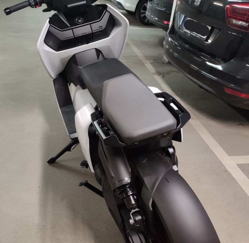

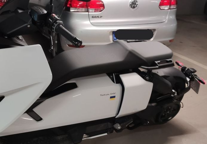

I hope somebody gives you some hints for Shad (I think that's a very good choice) and the needed rack. Unfortunately all these racks from third party (behind the seat, not on the passenger seat like from BMW) are not compatible with the racks for the saddle bags (side bags).
What nearly everybody bought and whats compatible with all these racks is the original lower part of the BMW rack with the handles.
https://www.leebmann24.de/catalog/produ ... 549445299/
The picture is wrong! It's only about the lower part on the picture and looks like this:
There are 4 holes in the handles to mount the upper part (then it uses the passenger's seat), which look a bit ugly. I've 3D-printed some cover plugs with which you can easily close these holes (just plug them in). Tell me, if I should send you some (just for the postal expenses, in germany quite cheap).

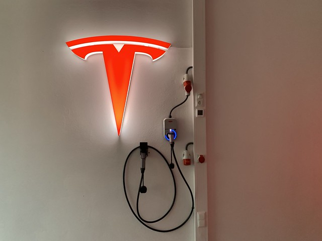

Autoladestation (könnte ich um Schnellladen auch für den CE04 verwenden):

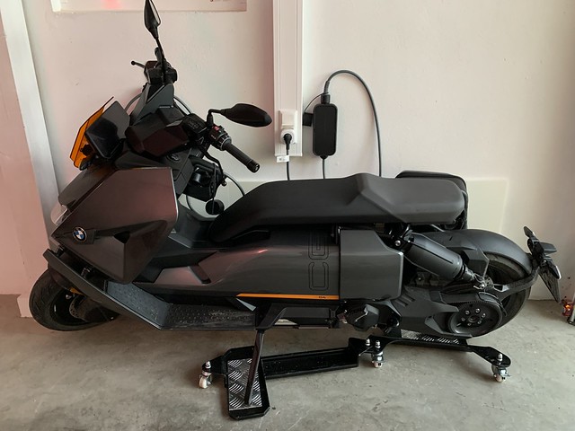

CE 04 Ladestation:
Die Plattform verwende ich um den CE 04 leichter verschieben zu können da dieser neben dem Auto steht und deshalb knapp zur Mauer geschoben werden muss.

Wow how much is this charging station ? And i m looking for a big one like 22kw cuz i m going to buy a tesla in December too but i m still interested in portable ones too

Was ist das für eine Plattform? Ich hab bislang nur welche für den Hauptständer gesehen. So ist es ja viel praktischer
