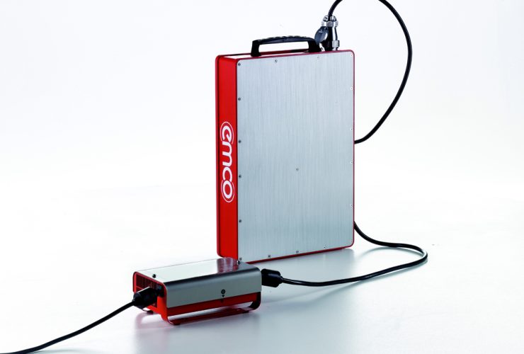

I am from The Netherlands and I was wondering if it would be possible to install the new Emco 2.0 Lithium batteries in a old Emco Novax (Lithium model).
New Emco battery:

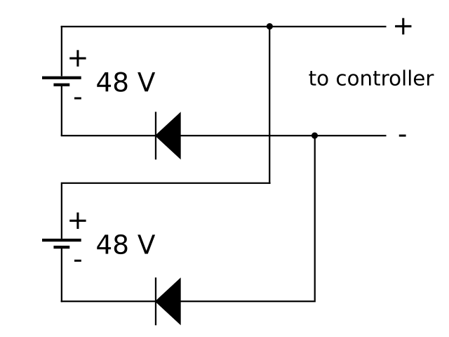

The simplest way to achieve a split box function would be inserting diodes into the minus lead of each battery, according to this (simplified) diagram:
Splitbox
Splitbox
The plus connector of each battery is used as a common connector for charging & discharging. To split discharge current only, diodes must be inserted into the "minus discharge" leads. If you want to charge both batteries simultaneously, additional diodes must be inserted into the "minus charge" leads.

For use in the Novax, the diodes should be capable of 100 Ampere current and to prevent overheating, they will need some kind of (passive) heatsink. Note that diodes will cause voltage loss of about 0,5 to 0,7 Volts. This results in a maximum power consumption of 42 A * 0,7 V ~ 29 W per discharging diode with both batteries connected and ~59 W with only one battery connected (it is not recommended, however, to operate the Novax with only one battery). To reduce voltage loss, use mosfets instead of diodes. Unfortunately, I don't have a diagram for such a circuitry.
Depending on the charger you want to use, each of the diodes used for charging must be able to take at least the maximum charging current, which is 15 Amperes when using an Emco quick charger.
The nominal voltage of the new batteries (48 V) is the same as the one the Novax runs on. So this should cause no problems. After removing the old BMS, you can connect the new batteries (via split box and overcurrent circuit breaker) directly to the controller's input.
