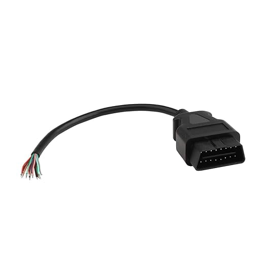

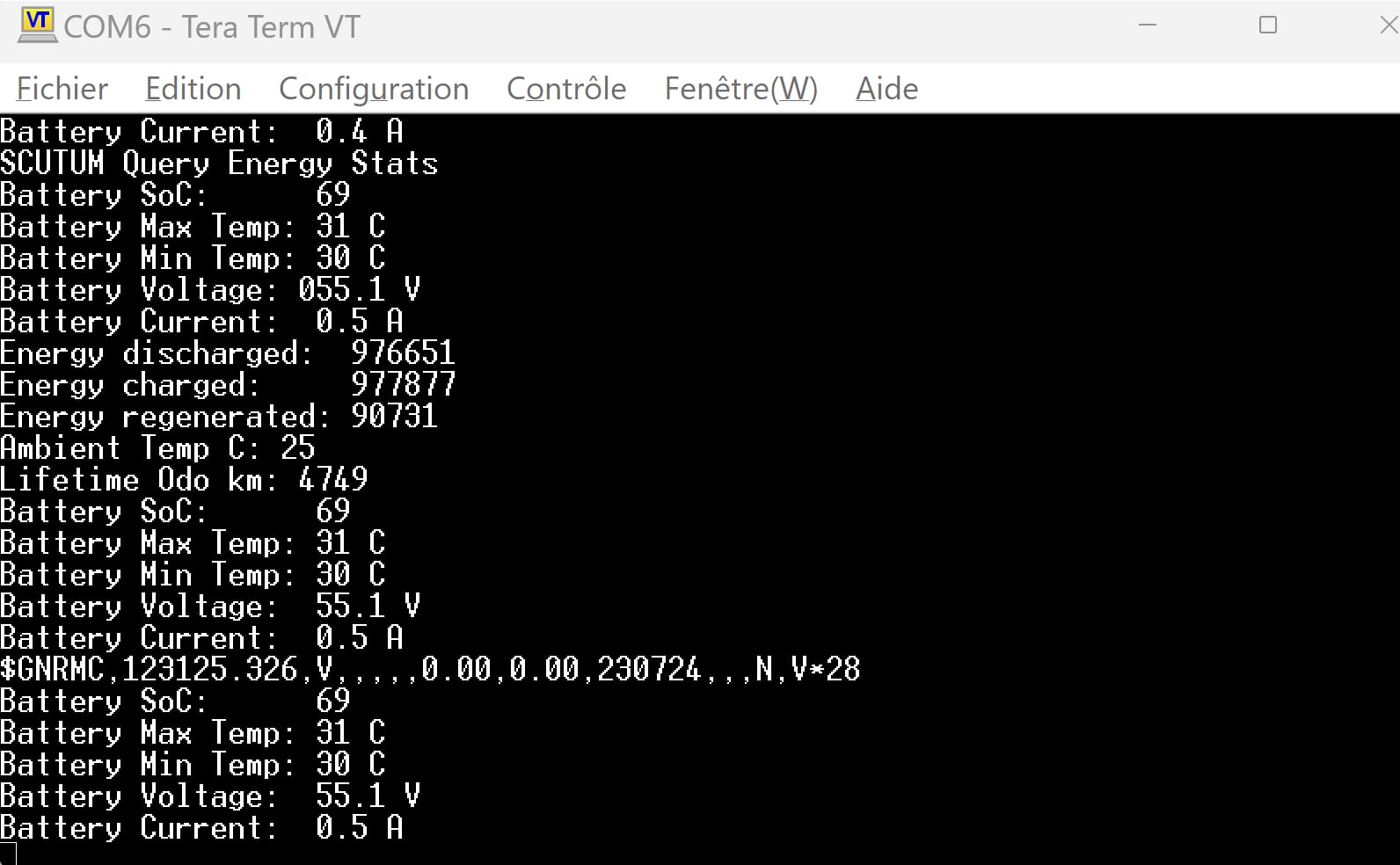

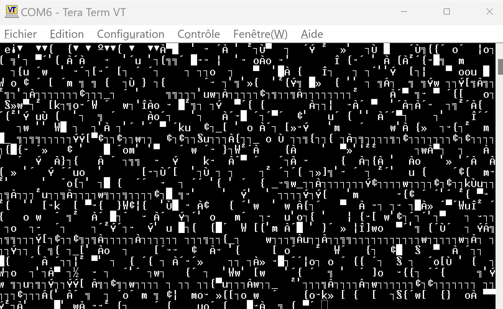

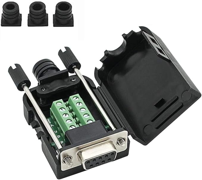

Hello,
I have a Seat Mo, and i'm trying to change my astra module setting to use the private server developed by Lorenzo Deluca: https://github.com/lorenzo-deluca/silen ... me-ov-file
i've plug odb/serial (male) adapter where I can move wires to a serial/usb-c adapter and for now, datas only get out on red wire from odb on serial pin#2.
I only can receive proper readable datas (battery, km used, etc..) when scooter is charging. As soon as I unplugged it, datas that get out look all corrupted like if transmission speed or charset are wrong, and I still don't achieve to send my $IPAD command 😭
see below:
any idea in how move on?
I have a doubt that my ground wire is not where it should, i put ODB grey in pin 5, and TW wire on PIN 3 (as 2 seems act as RX), does it look good?
many thanks for your feedbacks 🙏🙏

Welcome to Elektroroller-Forum.
For a correct wiring, see schematics in viewtopic.php?p=267822#p267822. DSUB9-GND (5, shield is not necessary) may be connected to OBD 4 or 5. Tx and Rx are related to the Astra modul, so you have to cross the lines: tx@OBD -> Rx@computer.
Basically, you got it to work, otherwise you would not see the readable lines in TeraTerm.
Note that the Astra minus supply and gnd is bridged to the vehicle GND via the main battery. If I draw out the main battery, I get similar data garbage from the Astra module 'cause there's no reference level. As long as the battery is locked into the scooter, it should do wether the battery is charged or not.
Most of the messages are only received if the scooters CAN is active, which is the case if you switch the scooter on or charge the battery. Otherwise there are almost no data on CAN and the Astra has nothing to tell on the serial debug port, besides the NMEA data (if configured).
