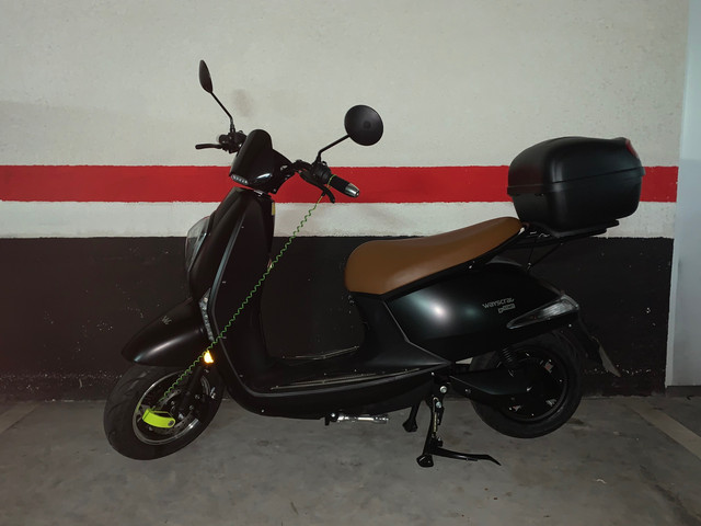

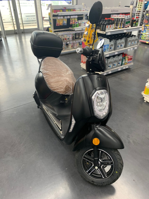

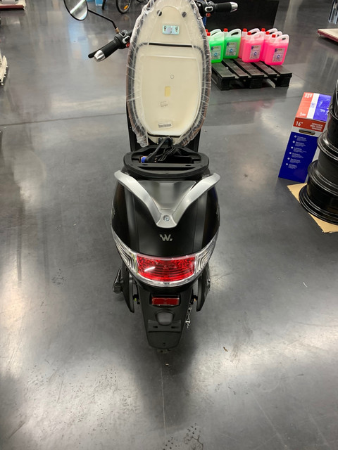

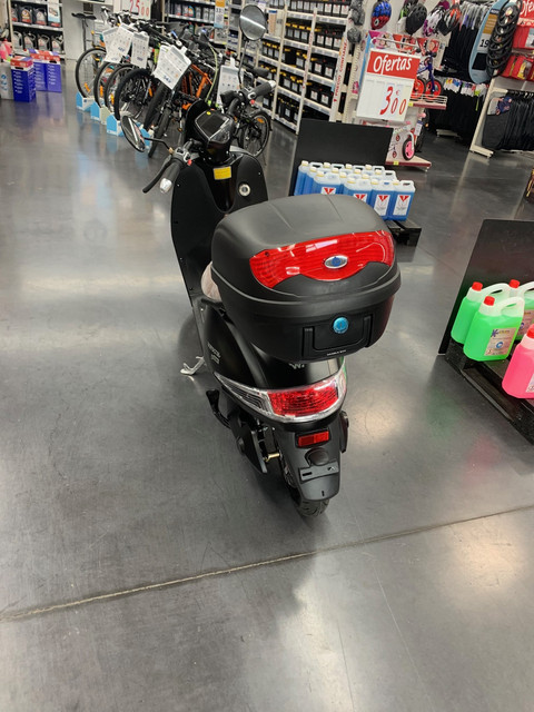

Hello from Spain,
I´ve recently bought one in Spain. Here the Wayscral E-start is sold in Norauto.
I've bought the rear rack and the top case. All for 49€
I´m interested in a LED bulb for the headlight? What kind of bulb is it? Any instructions to change it?
